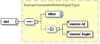

The del node is presented by type DomainTemplateDeleteInputType (domain_template.xsd). Its graphical representation is as follows:
image 32923
  • The filter node is required. It serves to specify the criteria by which the necessary service plans will be deleted from the database. Data type: DomainTemplateFilterType (domain_template.xsd). For details on the criteria, see the Available Filters section.
  • The owner-id node is optional. It specifies the ID of the service plan owner. Data type: integer.
  • The owner-login node is optional. It specifies the login name of the service plan owner. Data type: string.

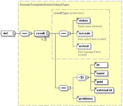

Response Packet Structure
The del node of the output XML packet is of type DomainTemplateDeleteOutputType (domain_template.xsd) which is structured as follows:
image 32926
  • The result node is required. It wraps the result of the del operation for a single service plan. Data type: resultType (common.xsd).
  • The status node is required. Specifies the execution status of the del operation. Data type: string. Allowed values: ok | error.
  • The errcode node is optional. Is required if the del operation fails. Returns the error code. Data type: unsignedInt.
  • The errtext node is optional. Returns the error message. Data type: string.
  • The id node is optional. If the request packet fails before the execution, this node is missing in the response packet. In all other cases it holds the identifier of the service plan (if this ID was specified in the request packet). Data type: integer.
  • The name node is optional. If the request packet fails before the execution, this node is missing in the response packet. In all other cases it holds the name of the service plan (if this name was specified in the request packet). Data type: string.
  • The guid node is optional. It holds the GUID of the service plan. Data type: string.
  • The external-id node is optional. It holds the ID of the service plan in the Panel components (for example, Business Manager). Data type: string.
  • The problems node is optional. It holds the description of conflicts occurred on completion of the operation. Data type: string.
