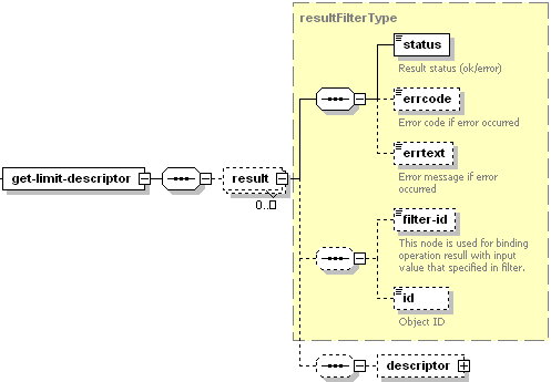

Response Packet Structure
The get-limit-descriptor node of the output XML packet is structured as follows:
image 40142
  • The result node is required. It wraps the response retrieved from the server. Data type: ResultFilterType (plesk_common.xsd).
  • The status node is required. It specifies the execution status of the get-limit-descriptor operation. Data type: string. Allowed values: ok | error.
  • The errcode node is optional. It is used to return the error code when the get-limit-descriptor operation fails. Data type: unsignedInt.
  • The errtext node is optional. Can be used to return the error message if the get-limit-descriptor operation fails. Data type: string.
  • The filter-id node is optional. It is required if the get-limit-descriptor operation succeeds. Returns either subscription name, subscription ID, customer name, or customer ID depending on a way of descriptor specification in the request packet. For info on filters, refer to the Filters of Descriptors section. Data type: anySimple.
  • The id node is optional. It is required if the get-limit-descriptor operation succeeds. Returns the unique identifier of the subscription. Data type: integer.
  • The descriptor node is optional. It specifies the object descriptor. For details, refer to Representation of Object Descriptor. Data type: string.
Note: This descriptor contains limits extensions. For details, refer to the Extension of Limits Descriptor section.
