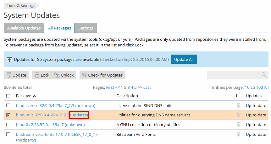

To view which repository is used to update a package:
  1. Go to Tools & Settings > Update and Upgrade Settings > the All Packages tab.
  2. Look at the Package column. For each package, the repository is displayed in the round brackets.

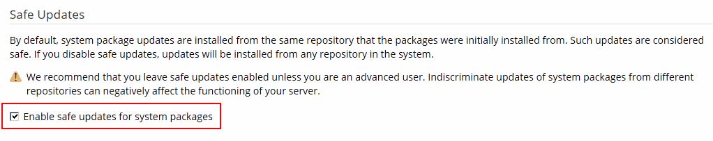

If you need to update a package from a different repository, disable s afe updates.
Disabling Safe Updates
If you disable safe updates, the System Updates tool no longer ensures that the updates are installed from the same repository as an initial package. The system package manager, such as yum or apt, manages updates in this case in the same way as it does without Plesk. Therefore, if there are other repositories available in the system, updates can be installed from them.
To disable safe updates:
  1. Go to Tools & Settings > System Updates.
  2. Clear the option Enable safe updates for system packages.

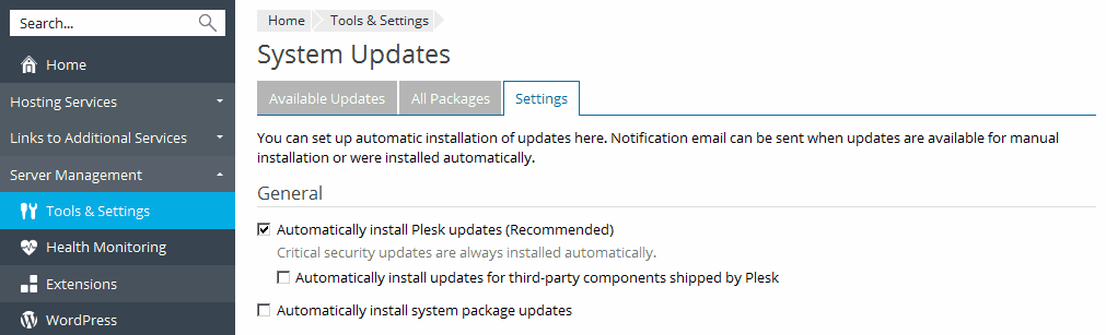

To update system packages automatically:
  1. Go to Tools & Settings > Server Management > System Updates > Settings.
    Alternatively, go to Tools & Settings > Update and Upgrade Settings.
  2. Select Automatically install system package updates.
  3. (Optionally, not recommended) Specify whether to disable safe updates. Learn more in Changing the Source of Updates.
  4. (Optionally) Specify notification settings in order to receive notifications about installed updates.
    image 76417
