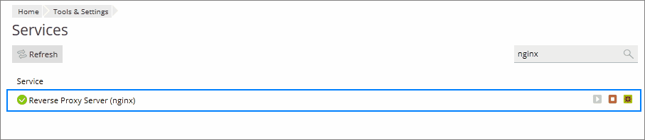

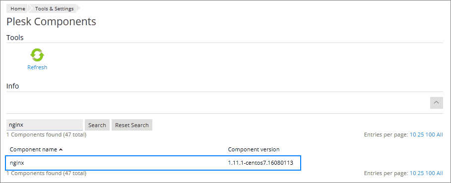

Make sure you have nginx web server updated to the latest version and running. You can do this on the Tools & Settings -> Server Components and the Tools & Settings -> Services Management pages.
image 76462
image 76463
