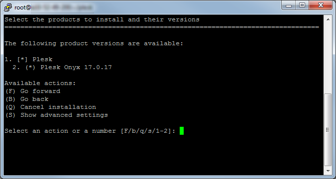

  4. Launch the installer
    Run the script to launch the interactive installer for the latest stable Plesk version in command line:
    # sh ./plesk-installer
    In the course of installation you will be asked a series of questions. You will be able to choose suitable options as well as go back to correct already selected options if necessary.
    image 77210

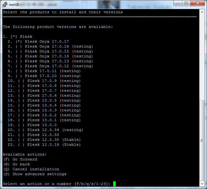

    Run the installer script with the --all-versions option to make all Plesk versions available for installing:
    # sh ./plesk-installer --all-versions
    image 77211

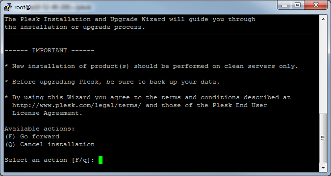

    Run the installer script with the --tier TIER_NAME option to view the latest available versions with the specified release tier:
    # sh ./plesk-installer --tier testing
    image 77212
